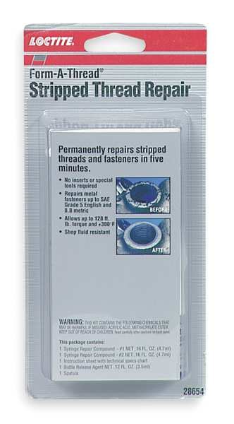

Maybe this will cinch it down enough to hold. Normally I would Heli-Coil it, but since it is cracked, no good.
Stripped Thread Repair Kit, 12.9mL, Gray Form-A-Thread
