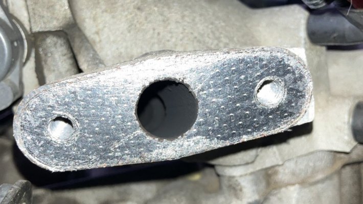

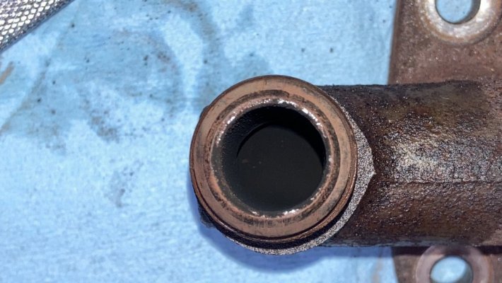

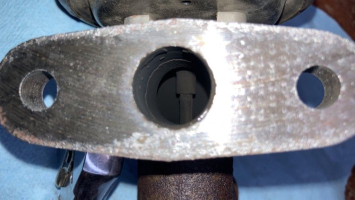

Gotta admit, I had to look up what a pintle is, learned it's sometimes paired to a gudgeon. Still not exactly sure so I'm posting multiple pictures.
The EGR came off easier than expected, nothing was corroded in place. It also looks way better than expected considering how bad the TB intake looked before it was cleaned. I'm wondering now if the best course of action is to just reinstall it.

The picture of the intake was before cleaning it a few years ago. Hadn't gone beyond that though which is why the surprise at how relatively clean the other parts looked. All I ended up doing was spray cleaning the EGR and reinstalling it. And losing a 10mm socket.
