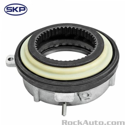

The hub actuators are known to leak vacuum after many years due to diaphragm failure, and that would allow hub engagement when you do not want it. So try giving the actual actuators a leak down test. Do you have a vacuum hand pump with a gauge on it ? If the actuators do not hold vacuum replace them and check for hub damage.

I've disassembled tested and bought replacements, there's no way to replicate a test to have it do it in a controlled setting ,the weight and load force aren't there when jacked up I'm still clueless.i appreciate the input and suggestions but yup tried it.
