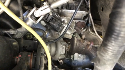

^Video of my Expy during a cold start.
Mine did the same. They replaced the VCT solenoids & catalytics and the noise was still there. They finally gave in and replaced the turbo a few days ago. they even stated the noise was "normal". I questioned them on if its normal then why the VCT and cat's? they have had the vehicle 11 weeks now.

I started the truck with the technician and service manager in the service bay.
I reved up truck, the tech heard the rattel.
I had him unplug the electrical connector to the wastegate. And rattel was gone. The tech was shocked, a turbo with such low miles was bad.
Before that I was explaing the issue to the service manager, They were trying to tell me that is normal.
So thats went we all took a walk to the truck. I had to show them the rattel. And how to stop the rattel by unplugging the electrical connector.
