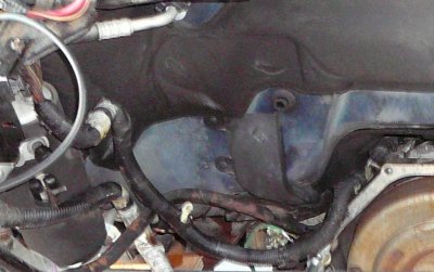

When I pulled up today I noticed there was leak under the EX after taking a quick look at it.
The leak is Coolent comming from the trans area I am thinking it for the rear HVAC system the heater tubes look like the go over or next to the trans but they look like hard lines are there rubber hoses up there I not seeing.
And Heads up what is this normal it has 130000 miles on it I sure hope it not a frezze plug.
Has any one else out there pulled these line out to repair them and is going to a pain to do.

I looked under the EX once again to get a better look at stuff the hose and hard lines seem fine What I can see the freeze plug look good the heater hose going in the fire wall no leaks.
The motor is dry I checked the Valley between the heads it dry.
The starter is wet not bad the major leak is at the trans right hand side just in front of the Trans cross member thats where it dripping at.
The Bell housing where it meets the trans is wet also.
HELP where is leaking at.

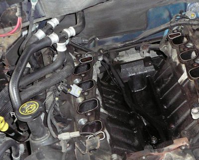

Took the EX apart was not that bad it looked like a pain.
It's the heater hard line you can see it where it was leaking at.
What concrens me now when I pulled the top Rad hose off the inside of the thermostate housing was muddy.
It could been old coolent or is something bad geting ready to go bad.

After work I got to pull the hard line out the rear nuts and studs kinda of a pain but they are out.
I put some air pressure on it to see where there leakng at so far no leaks I have some water in them now hanging and see if they leak it could be just the intake gasket after all and it's spraying on to the rear of the motor and the hard line.
