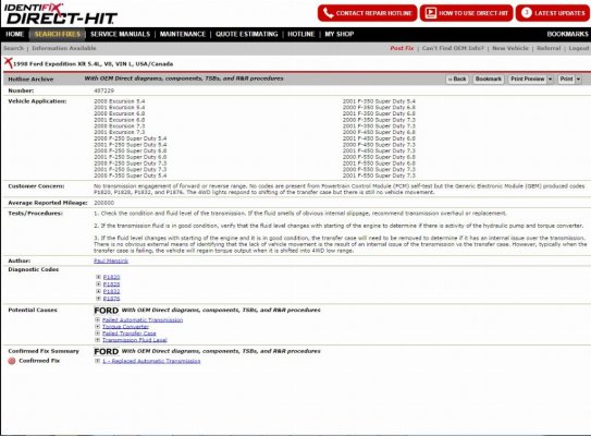

I looked up on Identifix and saw a few cases where "no movement" in reverse or forward was a transfer case. What keeps throwing me off is the truck can move once placed in 4hi/4lo (even though the ESOF does not always put it in awd/4hi/4lo)
Here's a screenshot of one that concerns me which the outcome i cannot afford and which is basically identical to my situation:
**Edit:
There is one difference from the screenshot- the Identifix concern show no movement what so ever if the X-fer case is placed in 4wd - The truck will move under it's own power when in AWD, 4Hi and 4lo.
