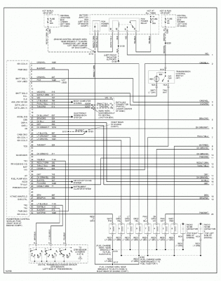

The fuel pump relay has constant, steady power but from what I can see on the diagram, the PCM controls the ground switch. So I’m leaning toward a bad computer. But this still doesn’t explain the pats issue or no communication to the PCM. The DLC has power.

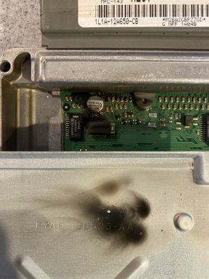

Pulled the computer out and took a look on the inside. I believe this is the problem. Come to find out, someone trying to be helpful washed the engine compartment and I believe they didn’t unhook the battery.
