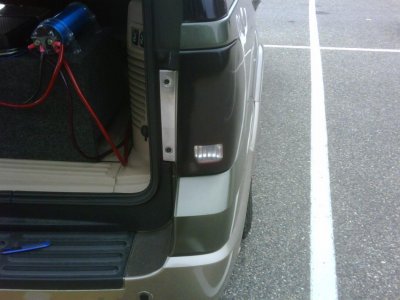

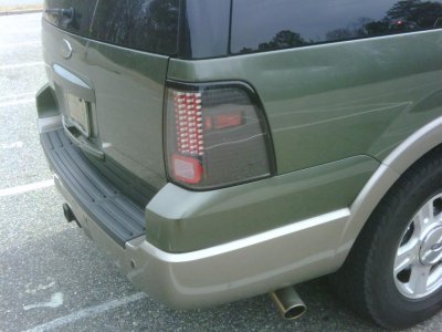

old pics... but still have the lights.... just have a hitch and roll pan now... guess I need to detail expy and take some new pics

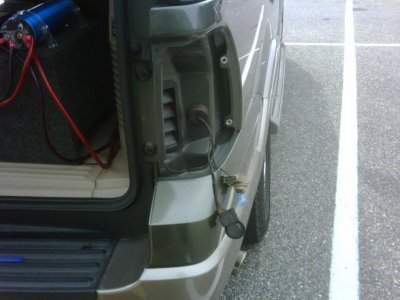

the end of the LEDs has the same base as the stock light bulb... so just plug and play... mine reused the stock back-up bulb... need to order a LED back-up bulb
14,561
888
Hampton, VA
everything is plug and play for tail lights...take out the bulb for the brake light and input to plug for the new lights...when you take out your reverse bulb (attached) just insert in new reverse area...they wont come with a reverse bulb so you must use your reverse bulb/wiring...nothing to take off or wire...just simply untwist from old light assy and twist in new assy...
