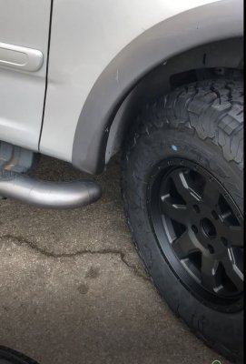

Hi, all. I have a project Expedition going and could use a little advice. I am the original owner of this 2000 Ford Expedition 4x4 XLT/Sport. I want to make it look a little more aggressive. I have tuned up the mechanical, will add rims/tires, and paint last. This is my first time doing a project like this.
Black rims with 33" BFGs are going on next week. I tested the rims/tires and there is a minor rub at the front bumper (video). So I have two questions for you.
Question #1: Cut the bumper ($50 at auto body shop next door) or spend the money on a lift/level of some sort?
Question #2: Do I have enough room on the back/inside of the front? The tire does no touch, and there is about 1/4"-1/2" clearance.
Question #3: Will this modification cause mechanical issues (someone suggested this will cause gearing issues)
I don't use this SUV for sport or going off road. It is 99% on a paved street or freeway.

View attachment 36485 View attachment 36484 View attachment 36483 View attachment 36482

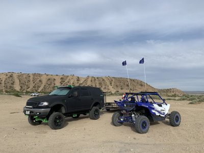

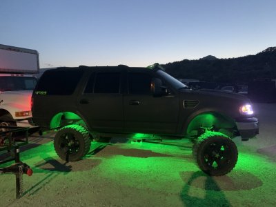

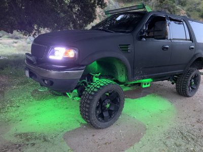

Hey, built a 4x4 off road expedition recently, you can easily trim the bumpers yourself with a sawzall with a fine tooth blade or a jig saw. That would also cost nothing. The more you crank the tortion bars the tougher it rides. I had a tortion loft and hated it. If you do decide to lift, do a suspension lift. This is mine if you haven’t seen it on here before.

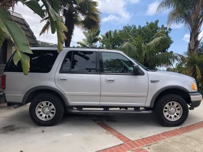

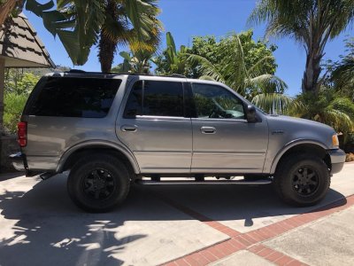

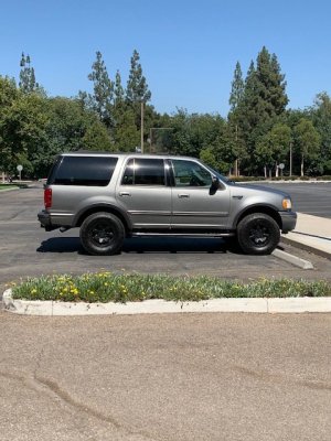

For the next person wresting with some of the questions I had, here is what my expy looked like before/after and what I did-with costs. Finally, the impact of the tires/rims.
New rims: 17 inch Level 8 Slam rim with -24mm offset, 5 x 135. The tires don't stick out. They are flush with the flared fender, which was exactly what I wanted.
Tires: Toyo ATIII (285/70/17) are 3.5% in diameter larger than the stock tires (265/70/17).
Tires + Rims installed/balanced-$1450.
New paint-$2500. Two coats of Pros Spray + clear coat. Body AA4 Phoenix Gray (Kia color), Trim-NH675M Magnesium Silver (Honda color).
As far as I can tell, the new tires at 3.5% larger than stock are causing my speedometer to be 1-2 MPH off. I have tested it on up/down grade and flat. It is always within 2 mph.
As for gas, I have taken three mileage measures. In one, I had better mileage than usual by about 2 mpg (14.9 mpg). In the second test, the mileage was about 1.5 mpg worse than usual (11.5 mpg). In the third, I was a hair below where I usually am at 12.5 mpg (busy day with freeway, city streets, A/C, and some idling). Historically, I get about 13 mpg depending on freeway vs. streets and A/C usage.
The feel of the Toyos is different than my prior tires. The Toyos are just a little rougher and noisier. But, not the least bit bothersome. I got used to the difference after a few minutes. I would not consider the Toyos "loud" or "rough" if I wasn't comparing them to the prior tires.
Next steps are to replace the headlights and to explore a two or three inch body lift.
Last thought...I did not man-up on cutting the bumper. I paid $40 to have the guy at the body shop cut it. After seeing what he did, I agree that I could have done that myself. Good luck to all of you out there with a project truck.

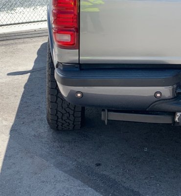

Forgot a pic of the "poke."
