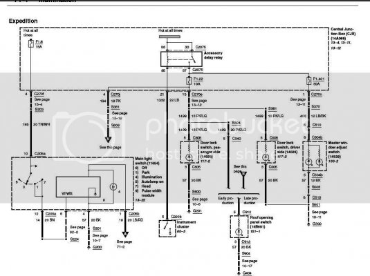

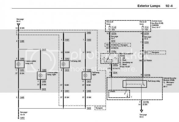

take into account i have 35w 5000k hids in my headlights and foglights
today in the morning everything worked, when i went to lunch i wanted to show one of my friends the hids so i turned them on and pulled the switch to turn on the foglights but the little light that indicates that the fogs are on didn't light up, i didn't think much of it
so then around 7 when i was cruising around with a friend i turned them on again the low beams and foglights and it was still not dark so i couldn't tell if the dash was on or not but i noticed in cars reflections that the foglights were off i pulled the switch in and out and nothing
as it got darker i tried again and noticed the dash running lights plate lights and foglights will not turn on
is a fuse a blown or is there another problem????
also does anyone know/have a fuse diagram i can look at?? and do you guys have any ideas which fuse(s) might be blown??
