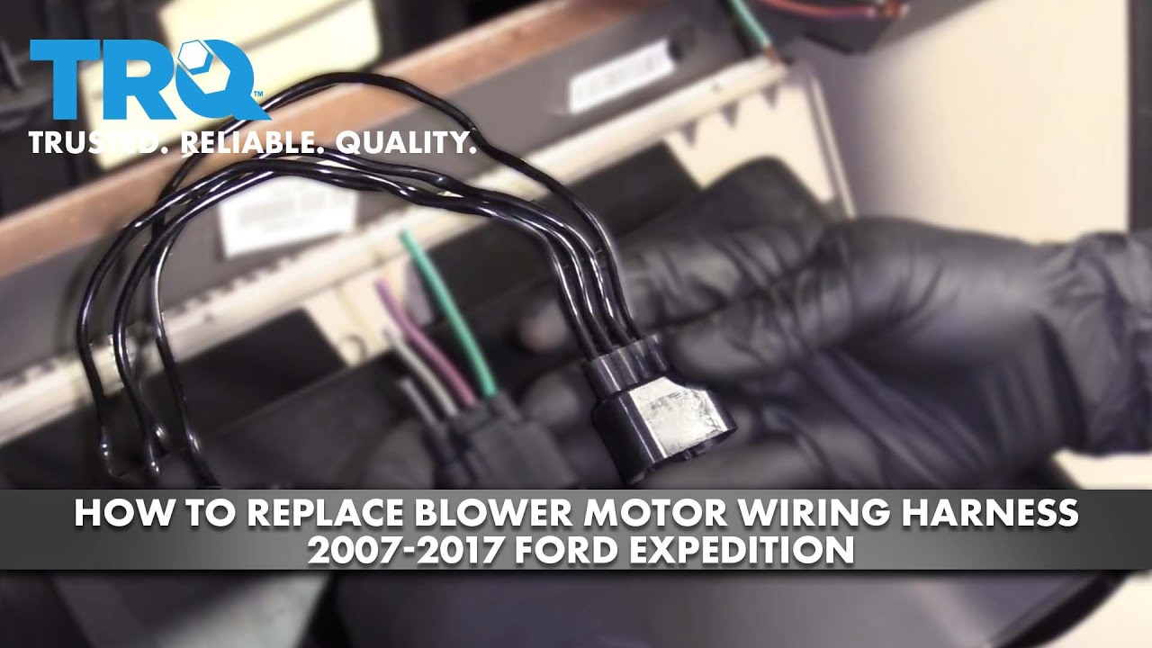

Look under the glovebox and examine the wiring harness and connector. Good chance the connector is burned or melted. You can wiggle the connector to see if the HVAC front fan begins to run.
There are numerous posts on this forum about the front HVAC fan not running and the wiring issues.
You may want to do a search and some reading.
There is also a safety recall to replace the front HVAC blower motor, which may catch fire. You can research the recall at: NHTSA.gov
