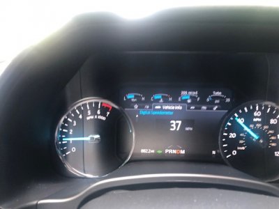

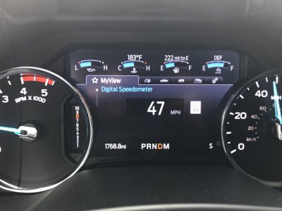

Hoping someone smarter than me has figured out how to display the posted speed limit on the Instrument cluster via Forscan or a specific build of Sync and can share what's required. I am only able to get the speed limit to display in the Expedition's IP when the Navigation/Compass screen is selected and a route is active. The picture below is from my 2020 F350, and is what I'm trying to accomplish if possible in my 2018 Expy. The F350 always shows the posted speed limit when the digital speedometer is selected even if no route is active on the Navigation system.
F350 has Sync 3.4 version 19274
Expy has Sync 3.4 version 20021

Are you sure the speed limit sign in the screen is not part of the new copilot 360 that can read the speed limit signs? My wife’s 2020 Aviator does the same thing. And if the cruise control is on it will automatically set the speed to the speed limit signs. You can also turn it off in the vehicle settings under the adaptive cruise. My Expy only knows the speed with the map data.

I am not aware of anything. Does the f350 allow you to toggle that speed limit on and off? If so, you could check the Forscan IPC settings before and after.

To my knowledge, Copilot 360 hasn't made it to the SuperDuty yet. The SuperDuty still has a manual foot activated parking brake, and to support full speed adaptive cruise like the Expy has, the vehicle needs an electronic parking brake. I suspect it is still using GPS map data to display the speed limit sign in the cluster vs. using camera sign recognition since it doesn't change to reduced speed limits in construction zones, etc. I also checked the cruise settings in my F350, and it only lets you select "normal" or "adaptive" but doesn't have any selections about the speed limit signs.

Talked with Clusters by Livnitup (https://www.clustersbylivnitup.com/) and he confirmed this feature is a firmware issue in the cluster vs. a Forscan or Sync related issue. Would need a 2020 owner to confirm if the speed limit displays next to the digital speedometer in the cluster like on the 2020 Super Duty. If so, he would need an image file from a 2020 to be able to offer this update to the firmware.
