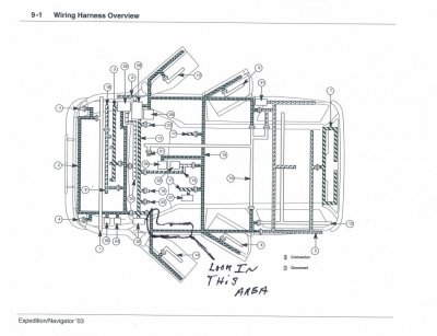

the attached is a copy of the fuse block for the 03 expy It may appear different than what is in the owners manual
Look at this print and you will see the large relays I would like you to remove C2075 Acc Delay Relay and replace it with the C2110 Trailer tow relay Then try the windows again and see if the radio shuts off when the door is opened
I tried it and still the radio kept working. Also, I noticed that the doors won't lock after I drive.
