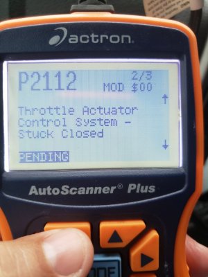

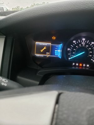

This morning I was coming around a bend to merge on to the highway and the truck just cut power. I was on the throttle and the wrench light came on and I had nothing. I pulled to the side and the car was acting like it had a really bad miss. I quickly shut it off. I looked up the wrench symbol "online" and it said it's usually for a 4wd fault or failure. I tried to start the truck and it started up like nothing was wrong. I drove to work and plugged in my computer and there's no code anywhere.
Any thoughts? Was this a momentary glitch?

It sounds like what mine did when the TB was sticking. I'll bet if you cold pull the code before restarting it you'll get P2112

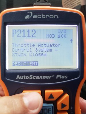

Nope that’s an electronic throttle body issue. Same thing happened on my 16 2 years ago. Warranty replacement solved issue. You need to take it back ASAP before you hurt your truck

Yup slap a new TB on it.
Like $120. Easy swap one of the bolts is a little tricky to get to but silly to pay someone to do it.

I have an Actron auto scanner plus with code connect. Its pretty advanced. It showed nothing at all. It will show permanent codes.
