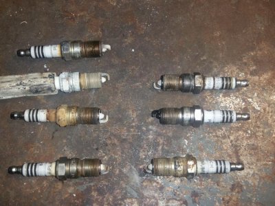

Attached is a photo of all the plugs. #3 was generating the misfire code, and was clearly not firing. fouled with oil/antifreeze and/or gas- something. I actually wiped off some of the gunk before the photo, but it was bad.
Plugs 6,7,and 8 on drivers side had a lot of fine dust I blew out of the holes before removing them. COP #6 looked terrible, so I replaced it. That plug also looks different from the others- not sure what this tells me. You can see it in the photo.
The plugs are laid out in order, with #1 missing since I cant remove it. They all look totally different- but all are the same age. Is this telling me I have a intake or head gasket leak? My pressure test didnt show any leakage, but can they be inconclusive?

docraymund
Feb 14, 2011
1,076
109
philippines
Yes, you need to check the cop connector to #3 cylinder with a noid light (there are vids on you tube on how to build that). If there is no pulse, check the wiring from the connector to the pcm for continuity. You need a repair manual for this.
