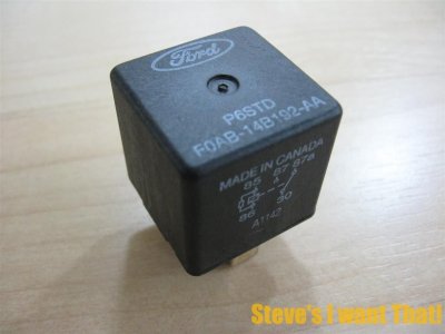

I go out to inspect. I hear a rapid-fire ticking sound -- several times a second. I check under the hood and touch all the relays. A tow connector relay is vibrating, so I pull it. All other relays are not vibrating, and the sound disappears. I then check all the under hood fuses and see a 20A cig lighter fuse blown. I pull that too. All other under hood fuses are ok.
I then notice the headlights are flashing very dimly on the wall. I open the door and hear a muffled rapid-fire ticking. I pull the passenger fuse panel cover and it gets louder. I touch the big relay in there and it is not vibrating. I pull the relay anyway but the sound continues. I test every fuse and they are all ok.
I cannot find what is ticking inside the car. If I turn the key to On, the ticking stops. When I take the key out, the ticking resumes. I tested the battery connected, and it showed 6+V. I disconnected the positive cable and it shows 12+V. (Naturally, the ticking stops w/ the battery disconnected.) I now have a wall charger on it just in case (+ cable still off though).
I do not remember touching anything under the car or under the hood and unintentionally completing a circuit. My 1st thought was that by leaving the key in On, I had drained the battery. Now I'm not sure. I hope I didn't screw up the ECU. Is there another relay or two hidden inside the passenger compartment?

I would take voltage readings again. To bring a 12v battery down to 6v with a load applied indicates a high amount of current draw. The clicking sound is an indication of low voltage.
You have electrical power if the relay is clicking - just not enough.
Get the user manual so that you can look up the different relays and what their purpose is. That way you can state specifically which relay & circuit is in question.
There are relays all over in the cabin.

Thanks for responding to my question. I did check the battery again and it is now at 12.5V. I connected the + cable back to it and attempted to start. It nearly turned over.
After doing some more research online, I now think it's the battery. It's over 4 years old. So it may have already been on its last legs, and my maintenance today pushed it over the edge. I'll let it charge overnight and try to start it again.
I also learned how to test a relay tonight. :) The tow connector relay I pulled is good.
