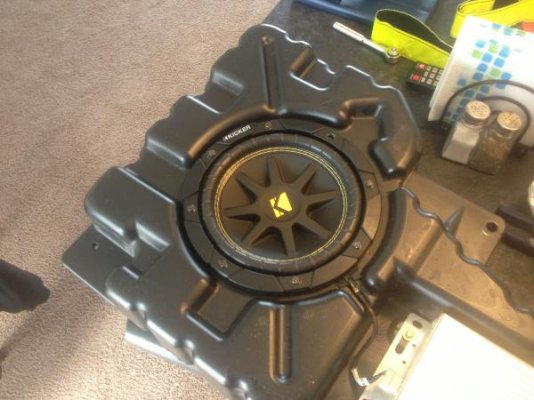

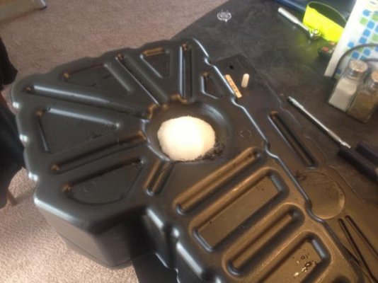

Here I had to cut about a half inch off with a dremel. Repacked with styrofoam which is held in place by the sub.
Here is the box with the sub installed.

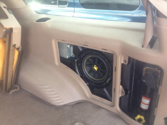

Here is the finished product.
Kicker Model 10C84. 8" 4 ohm single coil. 50-100w RMS. 200w Peak.

It wasn't too bad. I just pulled the panel out enough to get the box out so I didn't remove the seat belts. Took me about 15 mins to get the whole thing out.
