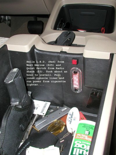

Anybody else miss having a light in the center console storage box ? I did. Got a small Hella Marine LED (red ) and a Radio Shack push-on-off switch installed. Ran power from the rear cigarette lighter on the rear of the center console.

Yeah when my original ashtray (factory option) broke (hinge broke off) I got a replacement piece from a model that came with the basic flat plate and power port there and took that power port out and installed the same kind of USB outlet you did. The only difference for mine was it was red LEDs that read the voltage. For what little good that would do me. But it is accurate anyway. I can see when the alternator is charging and not. For what that's worth.

When I installed everything for the radio connections in my console I completely overlooked I stalling a light. That thing is a cavernous beast and could really benefit from one.
I have looked into using 2 or 3 lights/diodes and having a magnetic reed switch installed towards the rear of the console lid. Being its unlikely I'd need light unless it's full open and I'm digging for something it would keep connections out of my way and all but guarantee the switch closes each time. Up front if I failed to fully latch it may be enough to not shut off my lights.
I've also considered just doing an led strip that is USB powered being I ran a couple ports in there to handle Android auto and carplay but I use wireless for my phone and the ports are free for power usage. Getting one to turn on without manipulating a control is the hard part because they generally have in line remotes for the affordable ones destined for a project like this.
