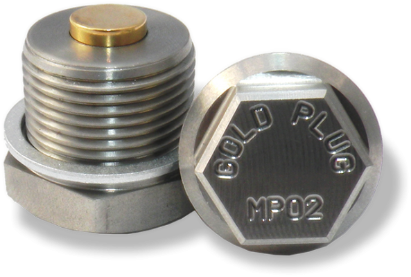

When I did my first oil change on my (ex-police) 2014 SSV, some idiot had used an impact wrench on the oil drain plug before. There was clear evidence of the plug having been cross-threaded and forced in.
I got it out, cleaned up the threads a bit and it went back in without a problem. I did order a replacement magnetic oil plug for my next oil change from Gold Plug LLC, though. They sell very high quality machined drain plugs with super strong magnets, made in the USA.
On our 5.4L 3-valves and their oil passage clogging problems, any extra protection can help! I'm going to buy another for the transfer case too, as the factory drain & fill plugs have no magnets on them (but they should!).
