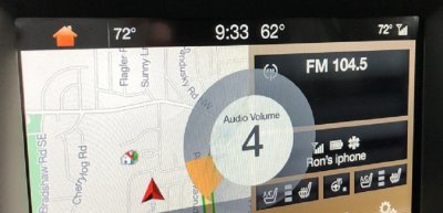

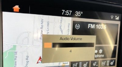

Another change to your Sync 3 screen for those who like something different:
Volume display - APIM 7D0-01-01 xxxx ?*** xxxx....change the ? to 0-Round (default), 1-Square (see pics)
