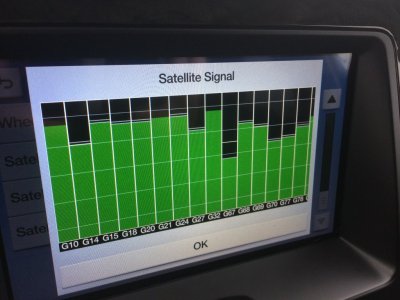

2. Then in the APIM module, the Navigation in Motion (7D0-02-01) worked, but Audio Equalizer (7D0-01-02) did not work, and also had another character automatically change. Audio Equalizer is for Sync 2, you have Sync 3...see spreadsheet in post #522...that's why it didn't work on your vehicle.
I tried holding [eject]+[next track] to reset the unit (read that somewhere) but it didn't do anything. This should have worked...try it again, but hold the two buttons (at the same time) for longer...after about 10-15 seconds, you should see something like the screen(s) on my next post (a lot of screens/info)

Example pics of what the Sync 3 Diagnostics screen shows you when you Press (and hold) the 'Eject' and 'Next Track' button at same time...around 10-15 seconds.
