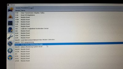

How does one actually locate the keyless entry code in ForScan. I see where it reads it in the log but how do I actually find what the code is?
What happens when you choose the option in FORScan?
If you're wanting to know the factory code, for 2015-2017 (and maybe other years), look behind the passenger kickpanel (where the passenger's right foot would be.) There's a module there that will have the factory code.

I have not found the section in ForScan it is just a readout in the startup/connection log. Nothing happens if you click on it.
Thanks for the video. Much easier to get to than my 02 Explorer. It was in the B pillar and took a bunch more effort to get to.

deweysmith
Nov 8, 2017
574
206
Montreal, QC
It runs for a second and displays the code.
Click the wrench, and then service producedures.
