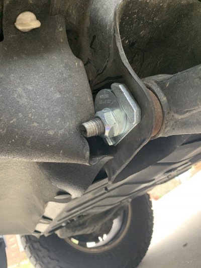

I went to retorque everything after driving it for a bit and found one nut on the sway bar endlink had backed off a touch after tightening it down the pop I had been having was gone.
Took it in for an alignment the other day and the factory alignment bushings in the lower control arms were seized so they put in some upgraded and extra adjustable SPC bushings that appear to pretty solid bushings. Hopefully so for $45 a pop.
