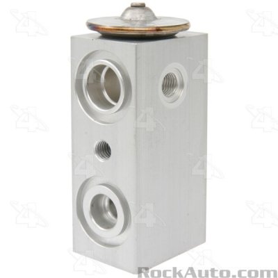

Kinda sounds like your front AC expansion valve is blocked. The expansion valve can also come apart inside, where the shaft detaches from the valve itself. Either way, you have to discharge the system and swap out the expansion valve for a new one and vacuum and recharge the system. Use new O-rings on the lines when you do the work.
https://www.rockauto.com/en/catalog...t+&+air+conditioning,a/c+expansion+valve,6788

Yep, I think hamfisted is on the right track. The only way the low-side line from the firewall would be warm inthat situation is if your expansion valve is plugged. Not an expensive fix if you do it yourself, but recommend having a shop evacuate your refrigerant if they are willing.
