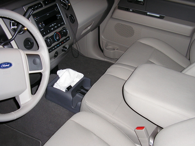

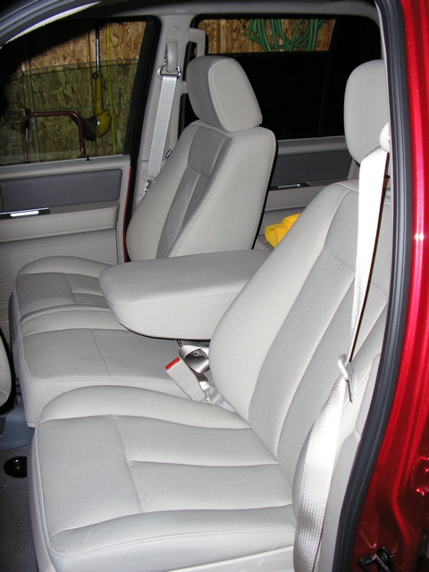

The 3rd Generations had a cloth front bench seat available up until 2008. All year 3rd and 4th Generation SSV's are standard with a column shifter and two bucket seats without the console. A F-150 center seat with fold-down armrest can be installed in these.
Some XL trims, when offered, were also available with a column shifter as an option, like the one in the link on Flex's post above. Note the steel wheels and rubber floor mats on that baby too! That's a rare car, probably originally ordered for someone to pull a trailer of show dogs or a government fleet use. The FCC, FRA and FAA orders them and installs laptop computers where the console is usually located.
The SSV package adds a black grille and black door handles, old-style manual heating controls and eliminates running boards.
