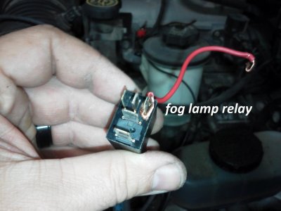

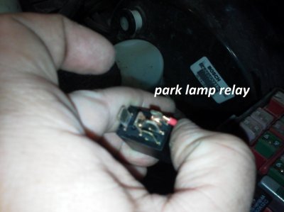

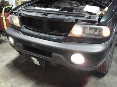

I did this to my Dodge Ram after reading a thread in the Dodge forum so I thought I would try it on my Navigator. I never take my headlight switch off of auto, so for that reason I never seem to use my fogs, but really like all the extra light I can get. So I ran a jumper from the park light relay to the fog lamp relay. Now whenever the park lights are on, the fogs are too. I've done the hard part by figuring out which posts to jump across, the rest is easy. I've had this on my Dodge for more than a year with no issues.
