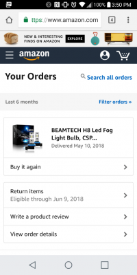

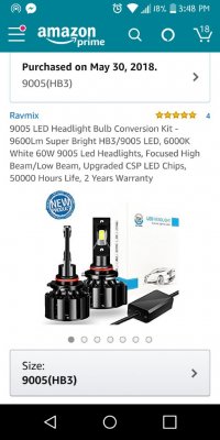

dlcorbett
Air Force
Mar 26, 2014
3,083
1,149
tx
Headlights in...its daytime but what a drastic difference it looks bright, how it shouldve been from jump the yellow halos were atrocious in any condition but sunlight...can't wait to see it at night in and in the rain, i wish i could put a led design like the factory ones but im hapoy with what i got...debating if i should put in the high beam bulbs later since the highbeams arent used often...shout out to dc man u came through with lbj clutchness with those bulb numbers

did you hook them up directly or get the antiflicker resistors
dlcorbett
Air Force
Mar 26, 2014
3,083
1,149
tx
They came with anti flicker modules
