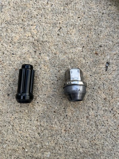

Are these correct? It’s the part number that matches, but the seat seems much smaller than stock.

For sure not the right ones. There is a part from Gorilla that has the wide seat like the lug in the right (believe they call it the 45 degree or wide cone) which is what you need. The smaller cone will dig into the rim.

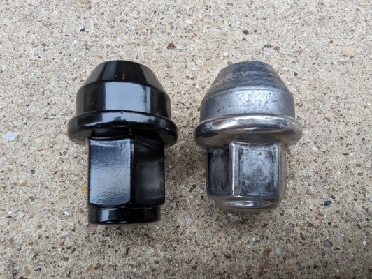

Unless you're really going for the spline, these are what I got a few months back to replace my swollen nuts. I originally bought a set from somewhere that had a smaller surface area like the ones pictured above and after doing a test install it was a definitely no-go with the lack of surface area. The thread type for reference is M14x1.5.

Good stuff. The ones in this link are a little longer than the Ford ones but not annoyingly so.

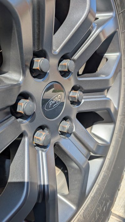

Before:

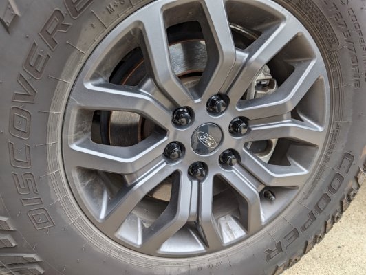

After:
