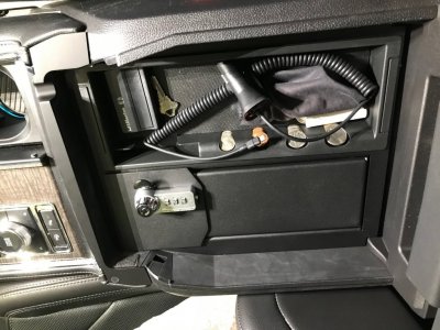

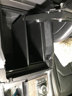

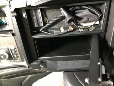

Just finished installing the E&G Classis console vault. I have to be honest, the craftsmanship and fit was perfect. Install took about 40 minutes but I also took it slow so as not to screw anything up. Very simple.
Couple install notes:
1) Be careful with the plate that slides under the console (you can see the black plate in the picture with the trim removed), it uses cages nuts (for anyone familiar with those) and they can pop off. Luckily mine didn't but they can. Make sure you slide the plate in on the left side and truly, don't pry up the console too much, I only had to pry it up about 1/4" or so to get the plate to slide in perfectly.
2) I also cut one of the corners off of the factory tray so that I can get a USB cable to still exit the console in the appropriate spot. The design of the vault doesn't have a spot for the cable to come through. Super simple, just cut the corner of with some dikes.
3) I disconnected all accessory cables that I could reach before removing the bezel, when those plastic clips pop, sometimes they come off hard, and I didn't want to risk pulling or breaking a connector.
Very impressed with this, well worth the money, I found a great deal on one at CarID, they were on sale for around 265. https://www.carid.com/eg-classics/console-lock-vault-mpn-7045-1000-17.html

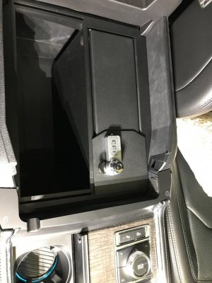

There are some cross members under the console that the metal plate goes under for the E&G vault, so it's more than just the thin plastic bottom of the console holding it in place. Someone would need to rip out the entire center console to get the safe out. Of course anything can be removed with enough time and effort but I'd suspect they'd just look for an easier target.So it’s pretty much the plastic bottom of the console that’s holding the safe in place? With the metal plate acting like a big washer? I have a Fort Knox safe that fits in there perfectly but wasn’t quite sure how to keep it down yet.
Awesome that’s what I was hoping for. Thanks!There are some cross members under the console that the metal plate goes under for the E&G vault, so it's more than just the thin plastic bottom of the console holding it in place. Someone would need to rip out the entire center console to get the safe out. Of course anything can be removed with enough time and effort but I'd suspect they'd just look for an easier target.
