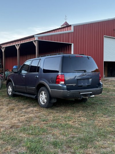

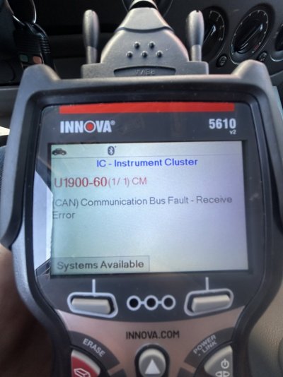

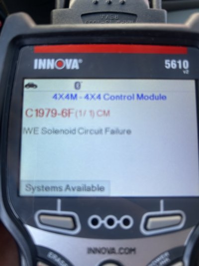

Could use some help with my 2005. I've got these 3 codes popped up on my 143,000 mile Expy. Any ideas on how to fix these codes? I'm also noticing my 5.4 is having a small tick on the passenger side, and its got a really loud whine to it. Any fixes to the noises? Can anybody identify the two tine trim color on my SUV? I know the main color is Medium Wedgewood Metallic, but cant figure out the trim color.

Lots to unpack here. For the paint I have no idea. It looks like an XLT and I thought the XLT was unpainted plastic trim. So someone here will correct me if I'm wrong, but I suspect the trim was painted due to fading. The local auto body supply house can scan your paint and mix a very close match at no additional cost above the paint. So that's an idea.

U1900-60 is a communication bus error and bus errors can be caused by faulty modules or faulty wiring. Based on this I suggest there is a good chance that this error is caused by the IWE solenoid failure, and slim chance the EVAP system fault.

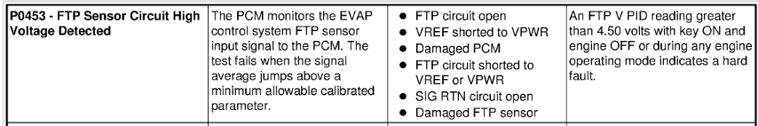

P0453 is the fuel tank pressure sensor.
HX24 DTC P0453: CHECK FOR HIGH FTP SENSOR VOLTAGE
Note:
The FTP sensor voltage with no pressure/vacuum on the fuel tank is between 2.4 and 2.8 volts.
- Key ON, engine OFF.
- Access the PCM and monitor the FTP V PID.
Is the voltage greater than 4.5 V?
Yes
- Key in OFF position.
- GO to HX25
No
- The fault that produced the DTC P0453 is intermittent.
- GO to Z1 See: Computers and Control Systems > Diagnostic Trouble Code Tests and Associated Procedures > Z: Intermittent - Pinpoint Test
HX25 CHECK THE FTP CIRCUIT FOR A SHORT TO VOLTAGE
- FTP Sensor connector disconnected.
- Measure the voltage between:
Is the voltage greater than 10.5 V?
Yes
- GO to HX26
C1979 is related to to the Integrated Wheel Ends(IWE) solenoid. It controls vacuum to the 4wd hubs which are disengaged with vacuum pressure. A faulty IWE solenoid is not that uncommon. Though it could be the fault is in the wiring. If the IWE solenoid isn't working you'll be turning the front axles all the time.
