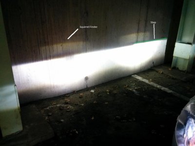

The halogen projector should have a squirrel finder and higher step on the right to allow you to see license plate and street signs and spot deer and others animals that could cause a collision. While this car headlight failed on both giving us a straight pattern light and a horrible output. We should all start filing complains.

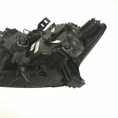

Perhaps I missed the earlier discussion, but why can't folks get some factory LED headlamps from a wrecked '18 Limited or Platinum and bolt those in? Is that a complicated swap? I have a 2017 XLT with halogen reflectors and it's really easy to swap those for factory projector lamps that are standard in 2017 Limited models. That's something I plan to do when I have time (and of course I have to acquire the parts).
taaangy234
Jul 12, 2019
52
30
US

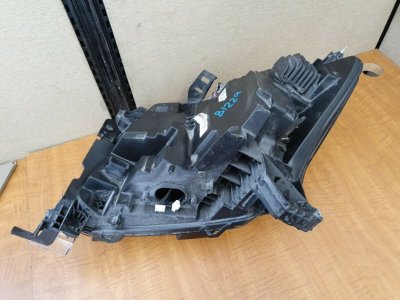

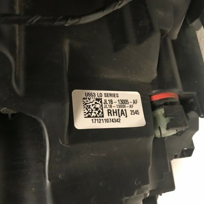

Not an easy swap, since the wiring plugs are different and not standard. You'll need to trace and slicing wires to make it works.
LED Headlight
XLT Halogen Headlight:

Gotcha. To me, wiring is usually the easy part (as long as you can get a "pigtail" to go with the new component, if not then a custom connector may have to be fabricated but I've done that before as well). As long as the new part can physically bolt in without major modifications, that should make it a straightforward swap. Things get really complicated though when you need a new module and/or reprogramming of the truck. Hopefully that's not the case here?

Apparently, even if you do get a pair of the oem led headlights, you still have to take the truck in and have Ford reprogram your computer. That is what everyone has been saying anyways.
