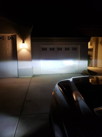

Also as you can see cutoffs still an issue for distance. Tomorrow I'll install the other side and might raise headlights with the adjustment just a smidge until ppl start flashing me like I have brights on then back it down till they dont. Right now even with these new bulbs in I haven't been flashed, so I know I got room to play with in hight adjustment.

Both look to be much brighter than stock.
I think I'd go with the flood more so than the beam for the low beams.
Low beams new Hikari on passenger side Beamtech on driver side. Positive more focused beam negative doesn't fit in housing as tight as stock or Beamtech it has a little wiggle to it very little but it could be tighter fit . I pulled it out rechecked everything reinstalled still tiny bit wiggle.3c6b60633f2b9f904436390bb5fa028a.jpg39ed5d2f502fb13c25b5f2899fec3c42.jpg

18-FX4-Guy, The cutoff on mine is quite a bit higher than yours and even starts to fade before the cutoff line. It may just be the picture, but I will estimate I have another 20-30yds of visibility. I am currently using Silverstars in the low beams.

Yeah my cutoff makes it so you get about 75 feet of light I got out and paced it the light had not faded yet. I'm going to adjust them a little higher pointing. It sucks at night where I live no street lights and we have burros and coyotes in the road a lot. At speed above 45 it's not enough light distance unless I have brights on. With all the oncomin traffic I get to hardly use them. I almost hit a burro a few months back and that was in my f 150 with the factory hid which gave me the brightness and distance of the highs with it lows and it had a cutoff too. I just hoping Morimoto or someone brings out hid complete headlight like they did for the new F 150 that work and looks awesome. Also my area very hilly and it makes it worse than that pic.

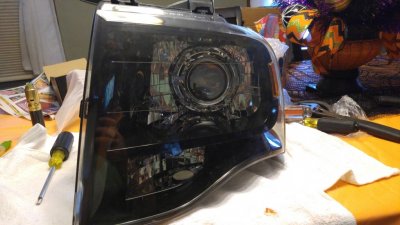

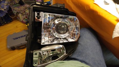

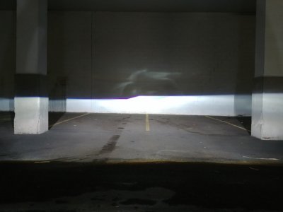

Another 3rd gen owner here to hopefully offer some assistance.
The proper way to set the height of your projector is to park on a level surface with a flat wall in front of you(25' away). Measure from the ground to the center of the projector lens. Whatever the measurement was subtract 2 inches. Thats the height of the lower portion of the cutoff line on the wall. Lower on left
Ive done a retrofit on my 07 and am currently working on another. If you have questions about the projector itself don't hesitate to ask

A Quality HID kit will definitely help.
I'm stressing quality because if the bulb doesn't have proper placement of the fillment you could see worse output than you have now.
Check out
Theretrofitsource.com
Diodedynamics.com
Lightwerkz.net
Expect to pay $150 for something or take a risk of being left in the dark
