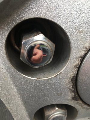

Ok, I’ve read the lug nut threads but have come away a bit confused. I have a 2017 XL Limited. The factory lug nuts are starting to swell and I want to replace them with something solid. What size do I need and where to order? Thanks!

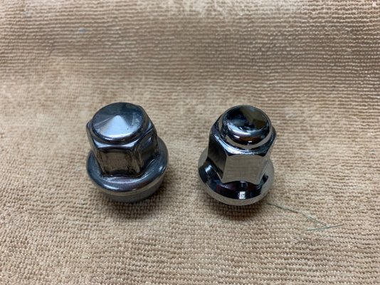

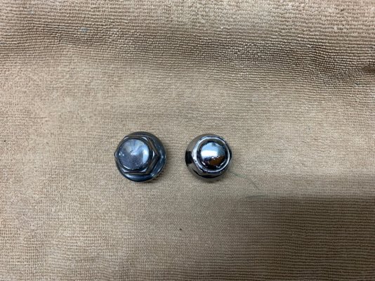

Took one of mine off and measured, 21mm or 13/16” wrench, 14x1.5 size, and overall length 1.6”. So the 1.4” size is too short. Low and behold, Gorilla now offers a “Factory style” for F150s that matches the stock dimensions, 61148CX. Ordered and should arrive in about a week. Will update after their arrival! Thanks!
Z4Mguy - Thanks for the info and the pics - where did you source the lug nuts? Thanks!
I had a hell of a time getting the stock ones off my 2007 limited last year. A few of them I had to cut the chrome cap off and then find a 20mm socket (just TRY to find one of those at your local store) to remove the lug nut.
Sure am glad I didn’t wait until I had a flat tire or something. Those stock ones were toast.
