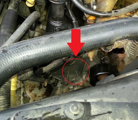

Ok so I ran down to Wally world and picked up a stethoscope. Listened around a bit and think I found where the sound is coming from. Sounds a little like a tick with a squeal....very hard to explain. Here's a pic of where the sound seems the loudest.

Sounds like the timing chain guides

I've been doing some reading and listening to other people's videos and I think you are right. How bad of a job is it on these engines? If I drive it am I likely to cause catostrophic failure?

Depending much of the guide has parted company will depend on how much damage will be caused. My son changed them on the expy that had 225 on the clock and they didn't sound anywhere near as bad as those.
You will also need the cam holding tool, we opted for two of them to make it easier.
These are interference engines, the valve stems are narrow, they will not tolerate being tapped by a piston. Make damn sure you are at TDC on #1 before pulling the chains. See the manual for step by step procedures to verify.
The biggest pain was the valve cover gaskets, both sides dropped out of the groove and leaked. Had to do them twice, siliconed the little sheets in place.
