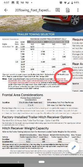

Thanks for all the previous suggestion when I was buying the Expy 2020. I bought one expedition Max 2020 with heavy towing package, attached the details here. 9000lbs towing capacity, 3.73 axle rate.
I have been reading and learning from the forum and YouTube, there are different voices regarding the full size SUV towing, someone suggested to tow less than 6k lbs and shorter than 25feet trailer, and there are a lot of ppl towing up to 8500lbs and 35 feet trailer.
As a first time tower , need help to check if my new Maxie ( my daughter called Expy nickname) can tow this trailer ( Bullet, 287QBS, end to end 33 feet) safely? We have a family of 5, 2 adults (300lbs in total) and 3 kids ( 150lbs) in total.
Thank you so much!!!

Yes. Use a good WDH with sway control.
What he said. Based on my own calculations anything longer than 25 feet will definitely be more prone to sway so avoiding that and making sure your weight is balanced properly will be crucial.

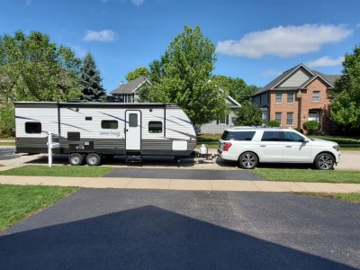

I rented this travel trailer recently for a trip with my two sons. Aspen trail le 26bh. 30' total length and about the same weights as the 287qbs you posted above. Since it was a rental with hitch, we weren't able to fine tune the WDH to our vehicle so the rear end sagged a little more than I cared for. Towing wise, it pulled with power to spare for sure. I did feel it a bit with a crosswind, especially when a semi passed but nothing crazy. It had a curt round bar WDH with sway control. Kept it below 65mph. This picture is with only about 100lbs of payload in the expedition before we got in. I purchased these helper springs and plan on installing them before we do it again.
https://www.etrailer.com/Vehicle-Suspension/Ford/Expedition/2020/CSS-1168.html?VehicleID=20205001928
