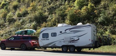

I have an Outdoors RV Creekside 18CK. It has a GVWR of 5900lbs, and weighs about that fully loaded. It also has tongue weight of about 900lbs. I've got about 12,000 towing miles on the Expedition with the trailer and have been really happy with the Expedition's performance. Over flat ground, it's very happy trundle along at 70mph in 10th gear at 1800rpm. And it'll do whatever I ask it over the passes, so long as I'm willing to pay for the fuel. And tow-haul mode uses as much engine braking as can be provided by a 3.5L v6.
As for tongue weight, you should not use the published hitch weight! It doesn't include batteries, or propane, or... My tongue weight is over twice the published tongue weight because my trailer has 500lbs of water just behind the front wall. But that doesn't mean you should use 12% either, as 12% is the minimum TW required for stable tracking. For a "can I tow this", use 15% (or use the internet to find out the tongue weights measured by existing owners of a given make/model).

View attachment 37076 Here’s a pic, although not a good one...
Shane ...do you have a WDH on that? It looks a little "squatty." If you don't ...I can't recommend one enough. I bought a Husky TS for the 800-1000# tongue weight for under $400 and is was the best towing investment I've ever made. The backend of my Expy only squatted half-inch once I got it all tuned and setup right.
Yes, I have a WDH with 1400lb bars. There’s a little squat (did I mention the 900lb tongue weight?), but this picture/angle exaggerates it.
