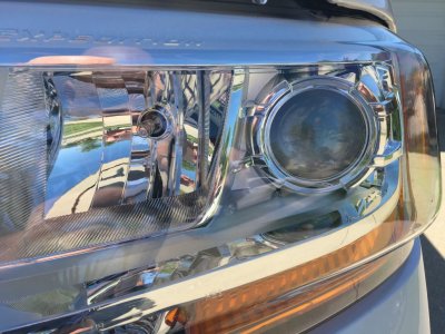

Here are my before and after photos of my Xenondepot.com HID headlight upgrade on my 2015 EL platinum. The new bulbs are 5000K and now match the OEM fog lights.
Post your upgrades!!
I switched out my halogens for HIDs in my projectors and the difference is night and day.
These were the halogens:
These are HIDs

What is up with the fireball-in-the-middle looking scatter patterns y'all getting from your HID lights???
You guys SURE you got proper projectors and not reflectors??????
It sure looks like a projector and that's what is says on the window stick but you'll have to ask Ford that question it's their design.

Well whatevs, their beam pattern is pretty darn odd...
Are your bulbs mounting up in the exact same position as the stock halos?? Same lengths and everything?
ExpeditionAndy
Aug 31, 2013
3,708
1,130
Fort Wayne, Indiana
Yes, in my case before I installed them I measured the stock bulbs and the location of the filament and compared that to the halogens and they were pretty much identical.
This is typical of putting HID in a halogen projector, Some projectors handle it different and will focus pretty well but not these. The fun begins when the UV from the HID actually burns the bowls of the halogen projector causing you to retro or buy a new housing.
It's funny but the Halogens had the same fireballs just a more yellow color. HIDs didn't change the pattern of my factory projectors. Just look at the pictures above.
I actually wasn't even talking about yours because in your pictures you look like you could be facing slightly down hill and not showing the same effect.
Huh.
Guess my assertion that Anzos, fugly though they may be, are actually half-decent projectors for HID retrofit --- at least for 35w HID --- gets some confirmation....
No scatter no bakein after a few hundred hours.
