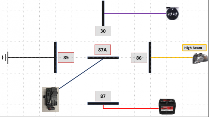

I have an 08 Ford Expedition Eddie Baur. I have gotten mine to stay on with a relay I wired up.
85 I tied into the right high beam wire. Mine was yellow/violet
86 Grounded to the relay mounting screw. Mounted the relay behind the right headlight.
30 Goes to the fog light signal wire
87A Is the signal wire to the fog lights from the SJB Violet/Gray
87 This is the wire that goes to the Battery.
So when the high beam comes on it trips the relay and cancels the signal from the SJB on 87A. Battery now runs the fog lights that stay on with the high beams. When high beams are not on then the SJB controls them through 30 and 87A which is normally closed. Here is a crude diagram.
