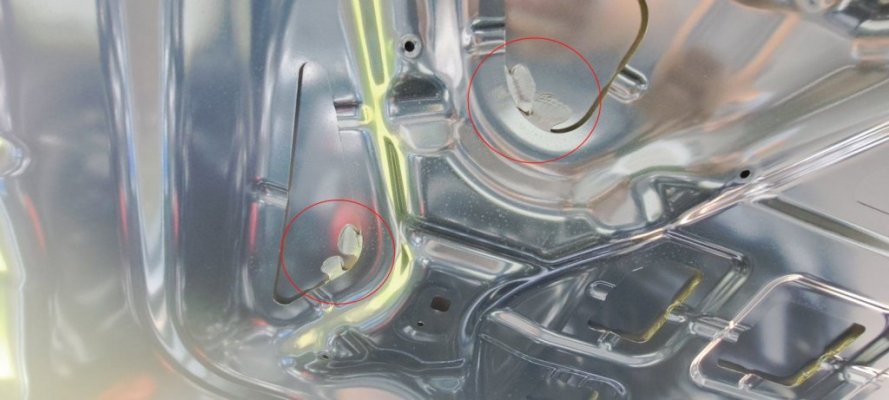

nema100
Dec 6, 2022
Minnesota
I had received a 2022 model as a loan when my 2019 went in for service. I noticed the 2022 didn't flop down the highway, so looked under the hood, and looks like plumbers putty-esh material is applied at certain areas. I have an insulation pad over mine and didn't want to chance ripping it just to see if these putty patches are there as well, I'm assuming not and it may be why the 2022 wasn't flopping. I'd be curious if that is the reason.
