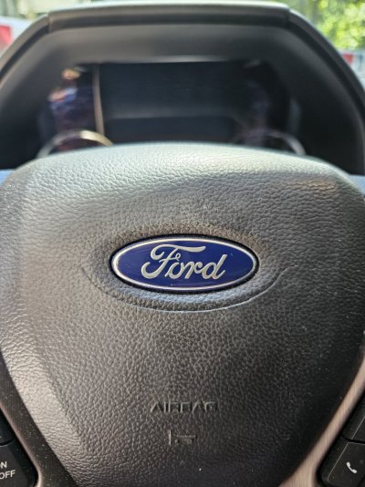

My horn cover just recently cracked when I honked the horn. My Expedition is a 2020 Platinum model that I purchased used in March 2023. It has 59K miles on it. When I took it to the dealer in Atlanta, they quoted me a little over $1800 to replace the entire steering wheel (parts and labor). I asked about just replacing the airbag assembly, but I have not received a response yet—any advice would be appreciated. Please see the image below.
exactly happened to my 2019 as well, 75k miles.... i barely use the horn but i think it cracked on a cold day. dealership replaced the airbag assembly, covered it under ESP. Note that as far as i understood, they did NOT replace the entire wheel - just the airbag assembly (which included the cover).
They don't need to replace the entire steering wheel, that's overkill and overpriced. Only the Steering Wheel Air Bag Module (Part #: FL3Z15043B13AF) needs replaced...much cheaper. See here: https://parts.ford.com/shop/en/us/e...g-wheel-air-bag-module-p-fl3z15043b13af?pdp=y . I've replaced several air bag modules on Fords and other makes and they are not that difficult...if you follow the appropriate safety procedures.
