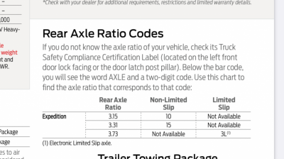

    Maybe this will help:

    If you have the ProTrailer Backup knob on your dash (to the right of the ignition button) you have the HD Tow Pack and the 3.73 rear end. If you have a little useless coin holder instead, you have the “standard” rear end.

    3.31. See where it says axle code on your white sticker...
