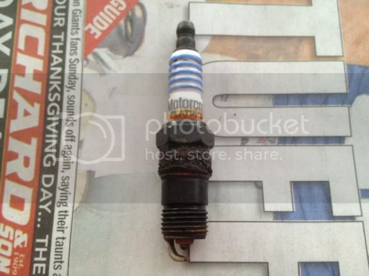

ON ANOTHER NOTE, WE PULLED WHAT SEEMS TO BE 2 ORIGINAL MOTORCRAFT PLUGS FROM THE ENGINE WHILE THE REST OF THEM WERE AUTOLITES... THEY CAME FROM THE 2 SPOTS IN THE BACK OF THE ENGINE, THE HARDEST 2 PLUGS TO REMOVE... GUESS THE LAST GUY DIDNT CARE... HERE IS A PIC OF ONE...
