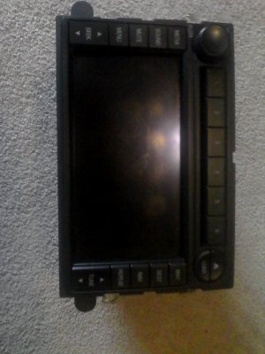

IMG_20190901_145245[1].jpg Ford 'made in Mexico' radios. The 'E series' vans and chassis all crap out. They sit directly over the engine dog house. The heat kills them. Ford continues to install the same bad radio, in there stripped chassis shuttles(says a lot about Ford). The radio is used in many different models, but they are vehicle specific, for some reason. The PCM controls, the on/off, for the delay shut off. Without the proper signal the radio won't turn on. I have a Navigation radio out of a 2007 Expedition, if anyone needs one. I was never able to use it or test it.
Thanks for the info, I didn't know that. It seems like getting one out of a scrap yard may be more complicated than just plugging it in, then.
P.S. I've sent you a private message.
