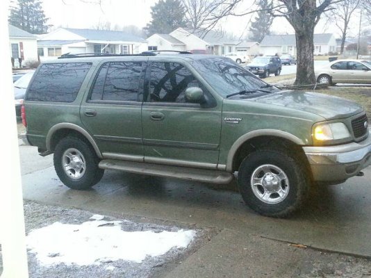

Hello,
I have a 99 Expedition EB, and I have done something to it and made it mad. I saw the other day that my power stearing fluid was just below the min mark on the resivour. So I bought some stearing fluid and filled it up to the max line. After that something in the engine started squeaking. It doesnt squeak with the turning, but it squeaks with the speed of the revs in the motor or transmission. every time the tranny shifts the squeak changes and gets quieter.
I thought that I mite have filled up the resivour to much, so I have been removing fluid slowly. Which is making the squeak quieter. but, at the rate I am removing the fluid I will be back at the min line again or below. I have not seen any external leaks and like it that way. lol. But, I need the resivour to have the correct amount of fluid and not squeak.
The other question is this. I have 265/70/17 tires on the truck, and want bigger tires without changing the suspention or body lift. What is the largest size tire that will fit without rubing. I would like wider better then taller if I could pick.
Thanks Guys...

I put 285/70/17 on mine I like the way it looks better than stock size. Fills wheel wells in a lot better and I have no lift on mine either.

Since you live in St. Cloud, you might see my truck around sometime haha. I also have 285's on mine (on 16" rims) and that is about all the bigger you will be able to fit without modification. As for the squeaking, does it sound like a bearing gone bad? Or more like the belt slipping?
