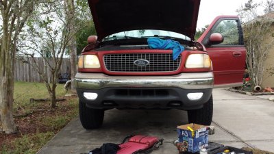

I thought I'd share my mechanical experiences on our new to me 1999 Expedition...

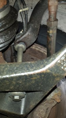

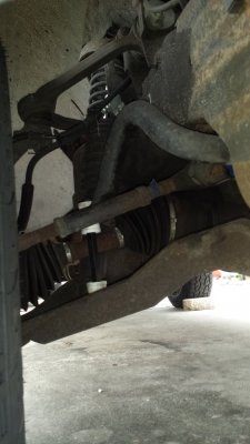

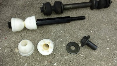

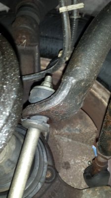

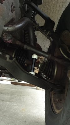

I will be replacing all sway bar bushings and links very soon since the truck and a bad lean/sway and play when turning. My BL said he replaced these about 30k ago. I'm shocked since parts of the link bushings are disintegrated and missing?!?! Not sure how or why this may have happened? I'm guessing the lift and weight of the truck has something to do with it?

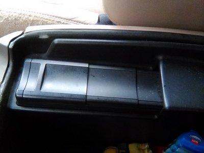

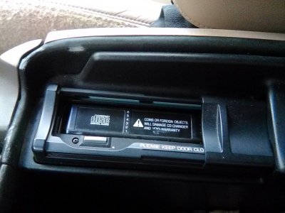

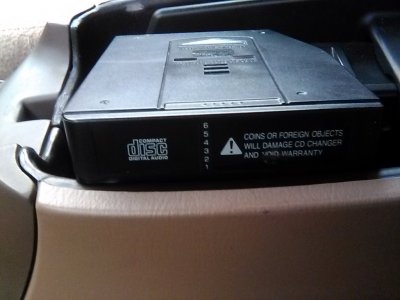

The cd changer is missing from the center armrest. Does anyone have pictures of what it looked like in place?

Also, before you buy speakers, check the brake line above the rear of the fuel tank. They rust there. And if the truck has a cable to control the shifter, replacing it may fix the difficult shifting. Sway bar bushings that fall apart at 30K miles is typical for Chinese auto parts store junk.

I have the factory cd changer if you want one I bought a 2000 Expedition with a new touch screen headunit in it, the factory changer won’t work with it, also the rear sheet should have a u snapped bar that folds down from the seat frame and inserts in a latch built into the floor

Thank you everyone for the replies! I ordered a set of links and bushings from Amazon and installed them today. Only the front for now since they were visually falling apart. I'll probably do the rear next week. Todays work, although not hard at all, takes a toll on my body and I'll be paying for it the net few days.
Here's what I bought and I can see/feel the difference: https://www.amazon.com/gp/product/B00CE3P9XO/ref=oh_aui_detailpage_o00_s00?ie=UTF8&psc=1
https://www.amazon.com/gp/product/B000C55ZOO/ref=oh_aui_detailpage_o00_s00?ie=UTF8&psc=1
I took the truck out for a drive and it is noticeably better on turns and when I shimmy the wheel side to side while driving. I'm sure doing the rear will make it as perfect as it's gonna get...
