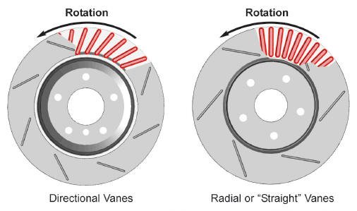

The 'big' end of the slot should face forward - like this:
With the rotor on the right side of this pic, I think the front of the truck would be on the left, thus, the slots look backwards.
Am I wrong with how I'm looking at that photo?

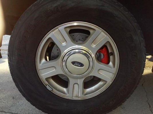

This is the front drivers side.

Okay, all fixed PLUS one of the caliper retaining springs broke so those were replaced.
Thank you for the heads up... I mixed them up and went with what looked logical.
