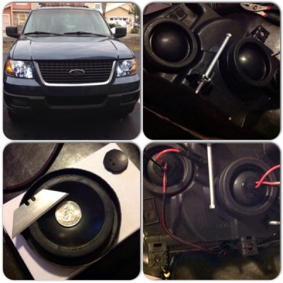

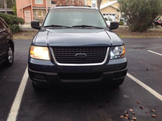

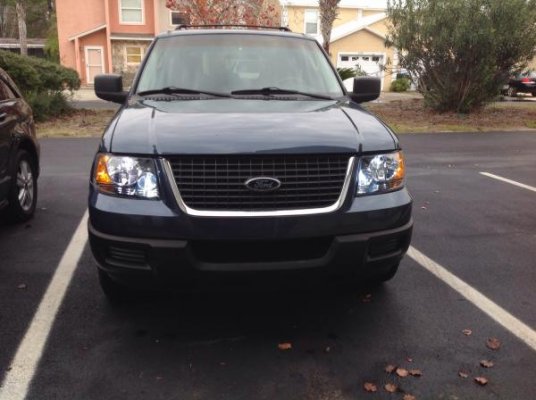

Changing the headlights to new housings and HIDs made me proud of "Big Blue" again.
I had the Chrome housings and here is the comparison pic.
Easy way to run the wires....

I installed HID high and low beams and it took about two hours.
Since I had purchased the new housings I prepped the lights inside relaxing.
The longest part of the job is the alignment. To align them I had to pull the housings half way out to be able to get the ratchet on them. Basically installing the lights 4 times. The real long bolt is not an adjustment. The smaller threaded bolt on the housing moves the lights inside of the housing.
I mounted the ballast using zip ties to a vertical support beam.
14,565
893
Newport News, VA
way too long...your aligment screw is the short screw sticking out horizontal at the top of the light...turn that and u will see the entire bulb move up/down pending on left/right turn...should've been 20 mins with most of that time finding where to secure the ballast...theyre plug and play to include the fogs...
the NEAT thing you did is with the wires...I just cut a small slit in mine but would've done it the way u did with the cover if I had known how...nevertheless 2 hrs is way to long just for install...are you counting the prep time of molding the wires in the 2hrs?

Lol.....Yes it can be done quicker.
...I was giving the "My Time" start to finish time, including unpacking the boxes, unpacking the HIDs, reading how the housings remove, finding my tools the modding the lights, mounting the ballast, waiting for it to get dark, having to adjust the lights by pulling both sides back out 4 times each. Plus I'm living on Beach time, no hurries no worries here .
The housings I ordered came with halogens already installed in the housing...so 6 bolts and 2 wiring harness clips and moving 2 park/turn bulbs is an easy installation.
Eagle Eye Brand DOT approved. $95. On eBay.
HID 35watt 6000k 9005 and 9006 bulbs with 4 ballast. $55. On eBay.
So $150.00 spent....made "Big Blue Look New"!
