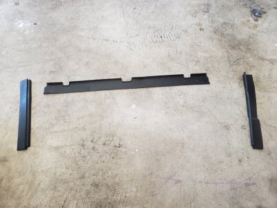

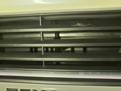

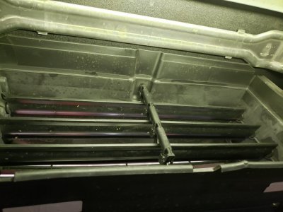

First fitment issue vs f150... We have motorized louvers and the install directions on f150 do not. Was instructed to remove a small shroud but our are 1 piece.20190908_131337.jpg 20190908_131337.jpg

Problem solved with razor blade. Super easy to cut and it runs up against harder plastic so you can make easy straight line while under vehicle still.20190908_133201.jpg

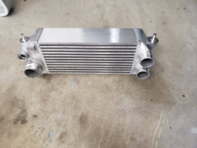

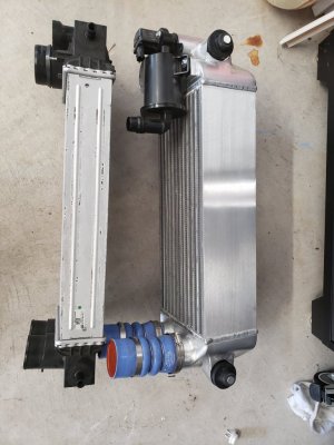

Took for quick drive. No leaks. About a 100 degrees today. Not saying this gives me anything extra in the hp department but it will make more consistent power now. :cool:
The new intercooler is at least an inch thicker and weighs quite a bit more than the stocker. I was amazed how light and cheap the stock one felt.
