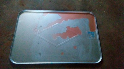

Leak or burp of coolant does not happen every day. Had at dealer a month ago they did not find anything and it was about a week before it did it again. Took back to dealer last week and they replaced Hose FL1Z8075A. It leaked again in about 2 days and has skipped a couple of days again. Taking back to dealer Monday.
It does not appear to be coming out the over flow tube or reservoir.
I suspect a water pump but they say it is not.
