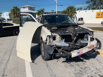

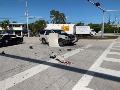

Also, after I finally got it fixed, within 6 months a truck hit it while I was waiting for a red light in Islamorada, FL Keys. @170,000 miles

Autumn Red, Wow, that was some hit!
